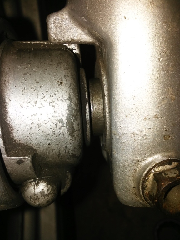

Evening Chaps,
Just done my head race bearings, was a bind.
Everything going back in now but can't seem to get the fork lowers to meet close enough on front wheel resulting in a large space (in my mind between the speedo drive and N/S fork). See below
Would people mind having a butch to see if their's are similar?
Thanks in advance
Front Forks lowers not meeting at the front wheel 20180811
Front Forks lowers not meeting at the front wheel 20180810

Post by Jameshambleton on Sun 12 Aug 2018, 7:58 pm
That's not normal.
Undo the axle pinch bolt seen on the right of your image, the fork should realign against the speedo drive.

Post by Prawn on Sun 12 Aug 2018, 8:25 pm
Thanks buddy
doesn't seem to do it unfortunately, still a large gap as before.
Did the fork seals a while back and ran one of the inner sanctions on glass and could feel a slight wobble/bend, may have got worse since then.
CB500 SX
Any one else can confirm this is isn't right/doesn't look right?

Post by teamster1975 on Sun 12 Aug 2018, 8:55 pm
Mine is exactly the same, albeit muckier so I wouldn't worry too much.

Post by Prawn on Sun 12 Aug 2018, 9:01 pm
Thanks Bud,
You've put my mind at ease, now to get on with the rest of the it!
