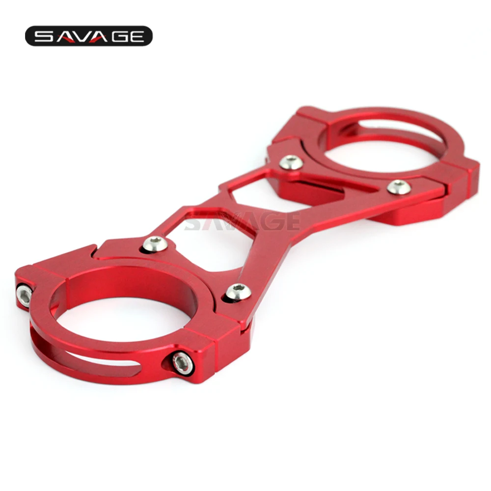

First we made it our self, but a brace from a CBR250R also fit
Try aliexpres, it is around 20 pounds

@bviep wrote: a brace from a CBR250R also fit
Link please.

Re: Front fork bracers.
Post by bviep on Sun 28 Oct 2018, 11:07 am
Click here
Don't know if it's working for you, because i'm from the Netherlands
If it doesn't work search for 'CBR250R brace'  and you will find it

Post by Beresford on Sun 28 Oct 2018, 12:46 pm
Yes, the link worked for me, but that brace looks very flimsy to my untutored eye. I'd much prefer a solid bridge piece. A fork brace is only going to be usefully functional when the going gets tough, but that one looked as if for show only. What do you think ?

Does indeed look flimsy, the braces I remember for big ol' 70's and 80's bikes were substantial things.
Btw the standard brace is enough for racing and also, having no mudguard? Style over substance imo.

Now, all this talk of fork brace - is it substantial enough and front mudguard yes or no made me think. I just had to go into the garage, dig out the guard and look at the standard one inside the front guard. I found it easily separated from the guard and with a bit (ok, a lot) of cleaning up and a coat or two of black gloss it can be fitted minus guard and would do the job and probably look the part (important). I also found I can just flex it by hand and I would think the ebay item would be more rigid. You pays your money and takes your choice.

Hi everyone, I'm very interested in anything to improve handling, bviep, are you sure the CBR250R will fit 'cos for the price I will definitely have one. As for being flimsy, I don't think I could bend one by hand and it's a brace, not a support!

Post by bviep on Tue 30 Oct 2018, 8:43 pm
Yes I’m sure! Got one myself, the CBR250/300R have the same fork diameter
Don’t know how to post pics here (iPhone), otherwise I’ll take a pic
It’s a extra brace over the stock one 1+1 makes 2
Me and my friends can notice the difference
