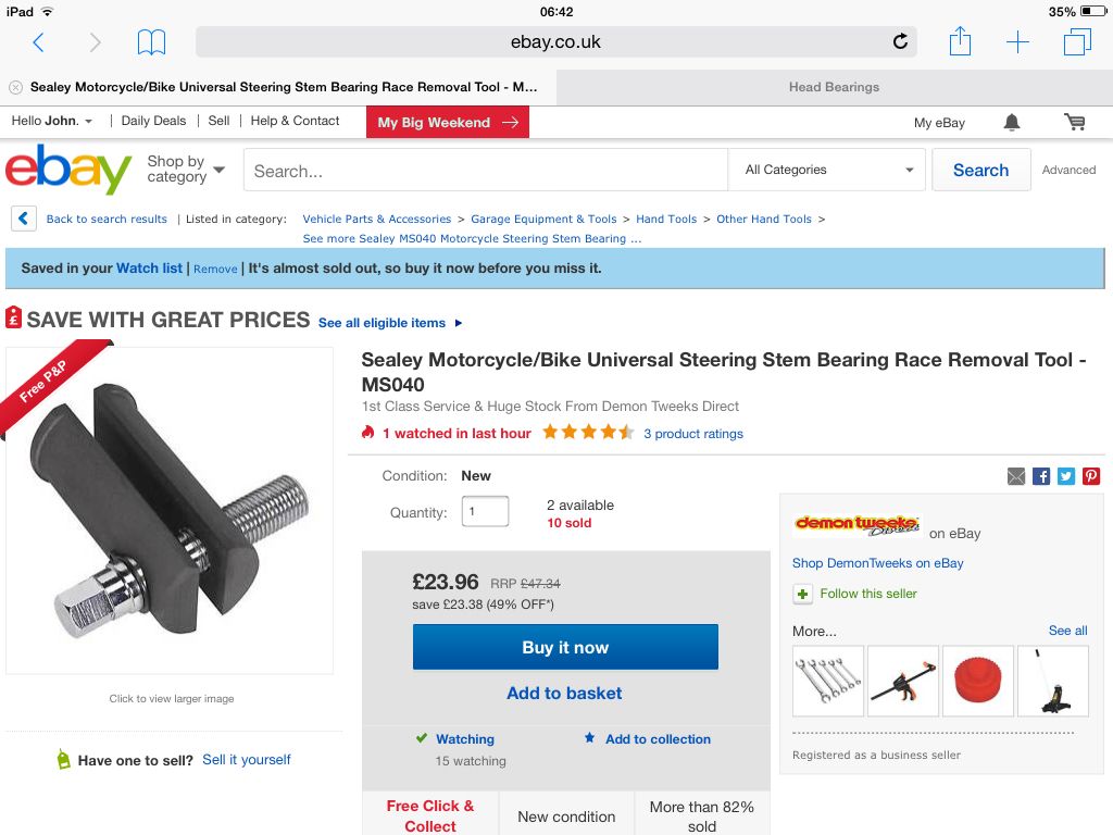

Available for Euro 94. Looks like this..

Or closer to Melitos's tool, one of these..
Head Bearings - Page 2 2f0eed00be66c65aeab140046e63092b_zpsi3kssejp

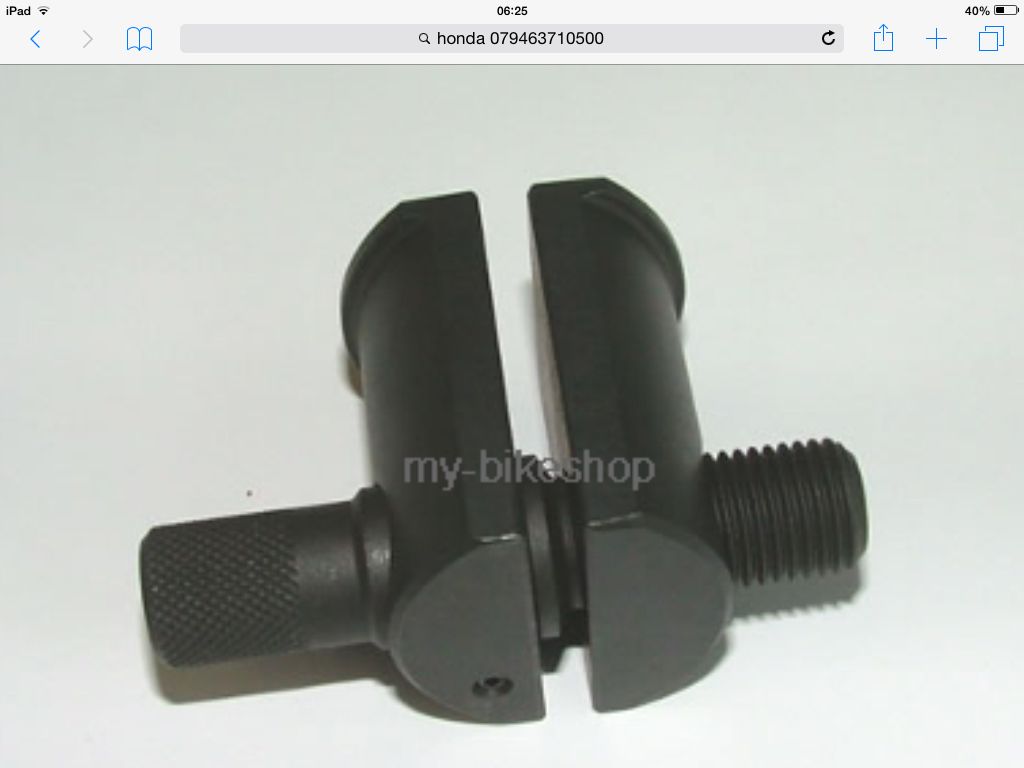

@sullivj wrote:Or closer to Melitos's tool, one of these..
that is the same type as the mechanics use to remove the wheel bearings and swing arm bearings, as they expand outwards to lodge against the bearing lip once through the dreaded spacers Honda put in.
To be honest, I don't see why they are needed. the bearings fit against a lip, so cannot be pushed in further than necessary
Hi
I have doubt that this tool would work. The change in diameter needs to be steeper in order for the tool to bite on the lip. That's why I had fairly short split cuts on my home-made tool.

Thanks for the diagram. Makes me think that the Sealey tool I linked to above, might just get on to the lip.

@sullivj wrote:Thanks for the diagram. Makes me think that the Sealey tool I linked to above, might just get on to the lip.
Hi
That might work. Possibly some grinding is needed to 'sharpen the claws' for a better grip to bearing race.
BR,
Antti

@Crash- Elmit wrote:Honda do a special tool for the bearings/races No's 07953-MJ10000 and 079463710500.
Have not yet had a chance to search the web for them
some links and pics appear to be missing on page 2 of the thread so my apologies if its been done already.
Available special order from David Silvers £120 for the pair.
Here's what they look like,
Honda Tools
One looks easy to fabricate, the other looks challenging...
