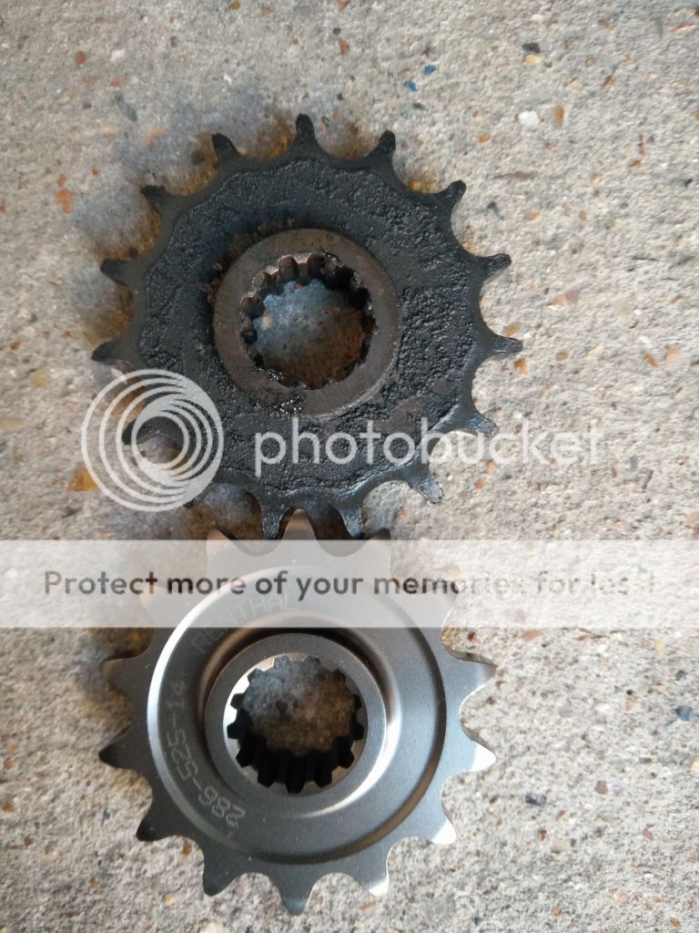

geewhizz
Posts : 623
Re: weird feeling coming on and off power
Post by geewhizz on Fri 29 Apr 2016, 12:02 pm
Ok Beresford I think I owe you a pint!! Great shout about changing the front sprocket. I just put in a 14t renthal sprocket, a quick ride round the block and the feeling seems to have gone. pictures of sprockets to follow...
