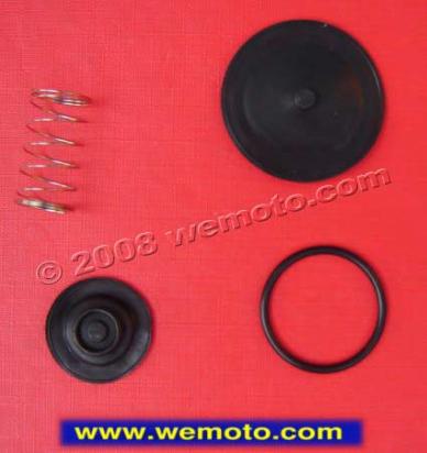

Would a service kit not sort it?
http://www.wemoto.com/bikes/honda/cb_500_sy_s2/00-02/picture/fuel_tap_repair_kit/

Has anyone had issues while putting in the fuel tap service kit?
I'm talking about the one mentioned in this thread earlier from wemoto.
For some reason the smaller rubber seal (bottom left corner) doesn't let any fuel through. I've tried installing it without the big membrane (so there is no pressure from the spring closing the fuel) but it's still not letting out even a drip.
Your help would be appreciated!

@ross_m wrote:Hi guys,
You have been sucking on the vacuum pipe haven't you? Else nothing will come out....

Yes I have. I've played with all this more. Now the gas does come out from the fuel tap when vacuum is applied. But the sad part is that there's too little of it coming out. The engine wouldn't even start.
