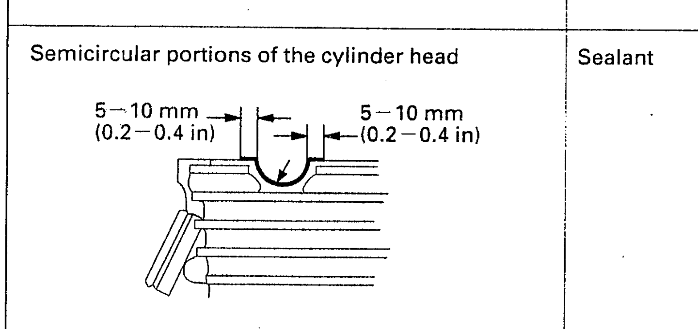

Honda say just to apply sealant in the semi-circular cutouts, but this may be wishful thinking when re-using the gasket, unless the gasket's in great nick and you fastidiously clean the mating surfaces and the gasket itself. If you do use sealant all round just be damn sure not to apply more than a light smear: if any gets inside and detaches and gets in oil passageways your engine's potentially in deep sh1t.

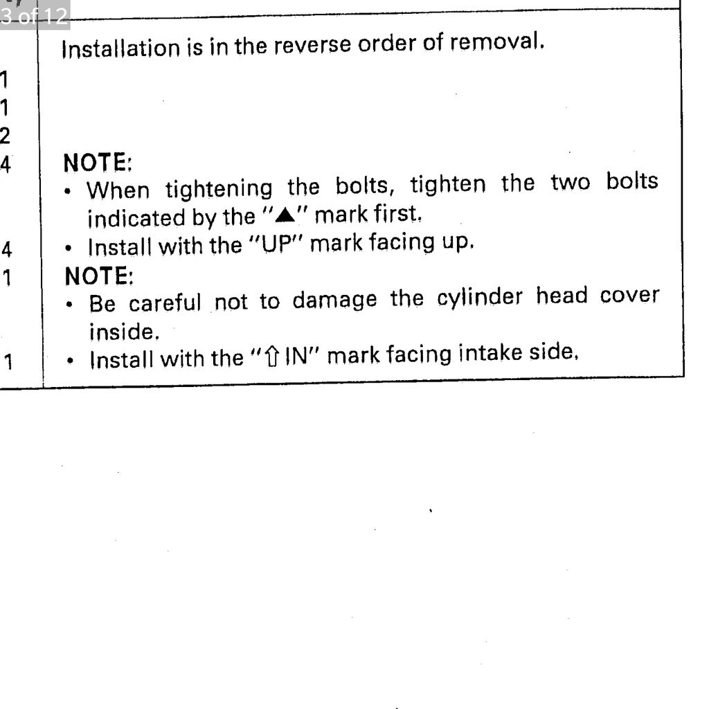

Just a little heads-up about this: I've just done my valve clearances and on reading the Honda manual (I've only used Haynes before) I notice that Haynes neglects to mention that the rear valve cover bolts should be tightened before the front ones. I didn't do this yesterday as I hadn't read the Honda manual that closely but will loosen them and re-tighten tonight starting with the rear ones. I've always had a smidgen of oil seepage around the cover gasket so it'll be interesting to see if this makes a difference. N.B. if the cover and the mating surface on the cylinder head are thoroughly cleaned with brake cleaner or similar then sealant should only be necessary in the semicircular cutouts, not all the way round, as specified by Honda.
