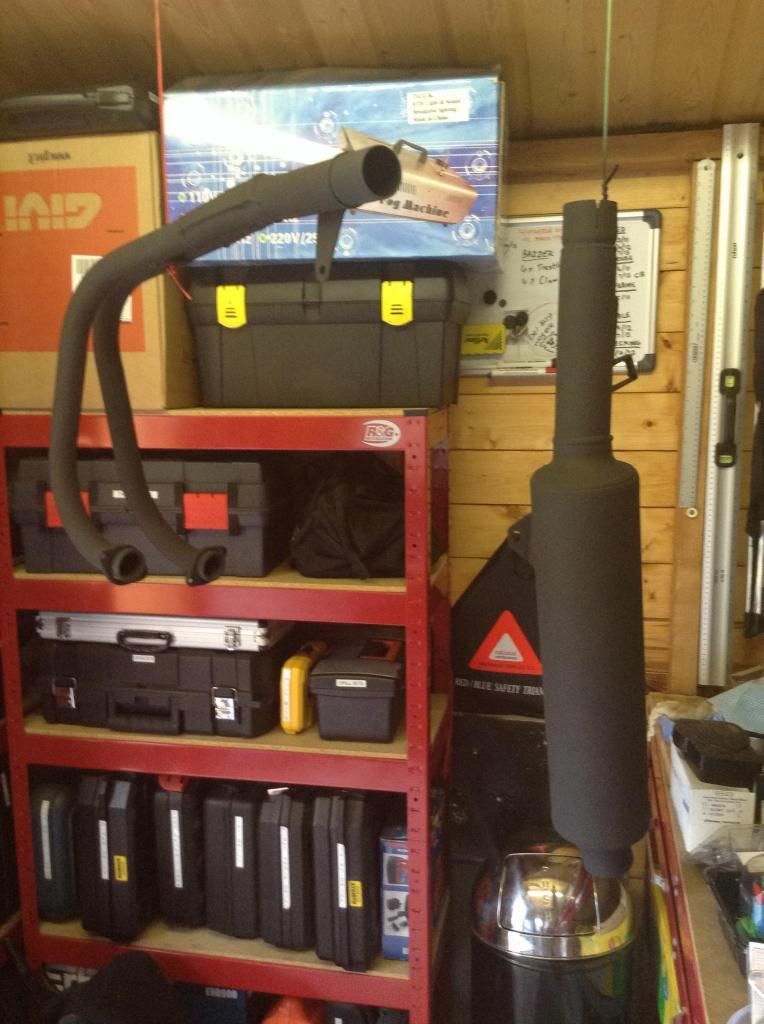

I used the Autotek VHT paint. It's £11.99ish for 2 500ml cans on Ebay.
It's been on for a couple of years and still looks good as new.
When it dried, it looked a bit 'matt'. So I polished it, which made for a much nicer finish.

Thanks for advice lads. Sullivj, i like your bike it looks mint. I like matt look on downpipes maybe not on silencer, your garage looks organised Laughing

I don't have a picture of it, but after I took these, I hand polished the silencer with Autoglym Super resin polish, and it shone it up really nicely. I have a brand new OEM exhaust 'in stock', and the finish on my sprayed one, is as close to that as I could get.
The workshop does have a touch of OCD about it!
