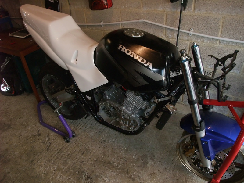

However I have made a little progress, new rearsets were fitted to see how they look and fit.
New Brembo front discs have arrived so I have been able to check that the wheel is central in the forks, which it is.
Now I'm happy with the wheels they can go of to be powder coated soon.
I have a one piece seat unit on it at the moment, still not sure whether I'm happy with it though.
The tank on it is just an outer skin and I plan to build an airbox to fit underneath it.
The fuel tank will be going under the tailpiece.
A few pictures

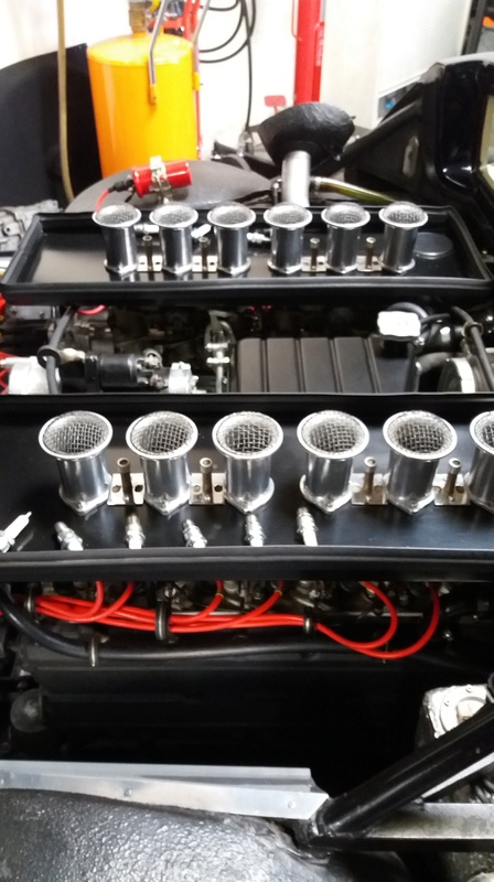

This is a 5.0 litre V10 engine for a Lamborghini Gallardo that I built up a few weeks ago.
