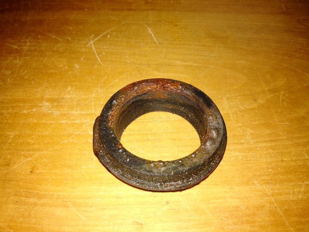

As promised yesterday, here's a picture of the underside of one of the dust seals from my forks, showing the terrible state they were in. The bike has 37k miles on, and I bought it at 13k. The oil had surely never been changed before I did it 2k ago.
Changed it all over today – new seals, new oil (obvs), and, since I had them from my last CB and never fitted them before I retired it, new bushes, rebound springs and damper rod piston rings. And new washers for the damper rod bolts, like a good boy. Just been for a 30-mile ride and it's all good.
I'm going to change my fork oil every 8k from now on. My previous CB's fork seals lasted from when I bought it at 24k to when I retired it at 145k, but I think that must have been partly luck (plus the gaiters I had fitted which are now on the new bike).
