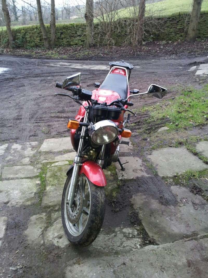

Got the bike home and it looked a bit sorry for itself. But so far, I’ve not come across any serious damage, hopefully it’s just cosmetic! Fingers-crossed!! Here’s a quick breakdown.
Screen: totalled
Mirrors: RH one is bent at the mounting point. LH one seems ok.

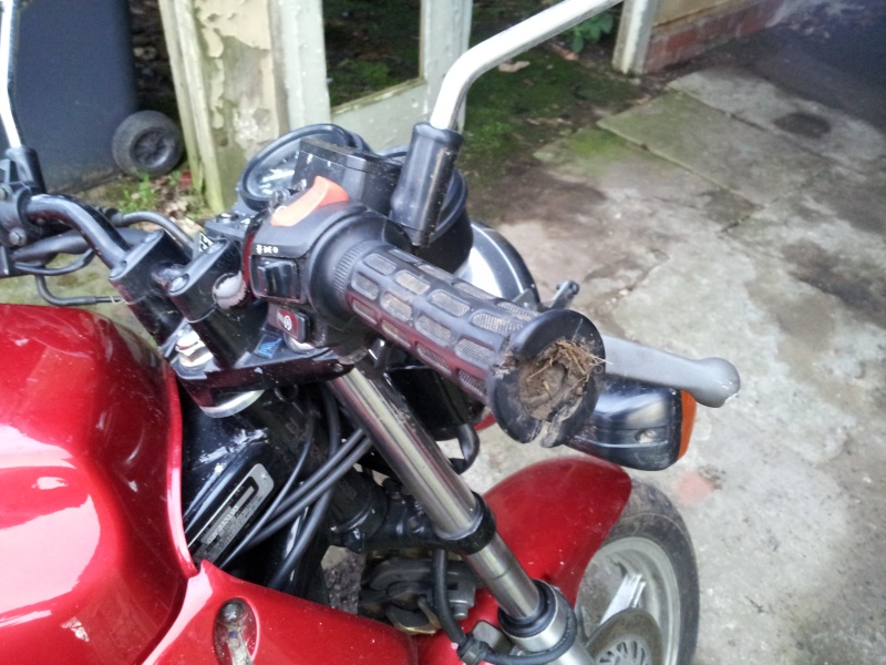

Bars and throttle: The powder coating has come away where the bars have bent slightly. RH end weight is clean gone and the throttle is jammed up with mud, grass and crap.
Front brake lever: Bent upward. Slightly annoying as I’d only replaced it in September!

A quick glance at the bars and they don’t look too bad. But sitting on the bike you can feel that the throttle side is bent forward and upward slightly. I don’t think I’ll manage to bend them back properly, so a replacements required.
I’ve not decided what to do about this yet … 2nd hand or OEM replacement would be easiest … but part of me fancies trying out some wider Renthals…
Checking out the throttle was next on the list. Opening the switchgear body showed everything at that end was ok. So, I removed the throttle grip itself. Naturally, freeing the cables to take this one item off involves removing all bodywork and the tank!
Boxing Day - CB500 vs. Diesel / Mud / Horse S**t /  20130129
Boxing Day - CB500 vs. Diesel / Mud / Horse S**t /  20130130
Boxing Day - CB500 vs. Diesel / Mud / Horse S**t /  20130131
The plastic throttle tube had shattered, so that was another addition to the parts required list. Anyway, I took the opportunity to take a few photos of the cable routing for future reference, particularly if I go with the Renthals and need extended cables. The light (and temperature!) were dropping by the time I’d got the tank and panels back on so that called it a day.
